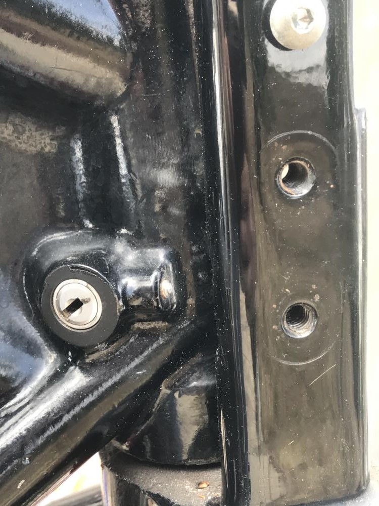

This is the position of the key when it's in the locked position. When unlocked, the key slot is parallel to the steering neck.
The lock is held in place by the screw coming in at a 90 degree angle on the right. It's a small grub screw down in the hole. It tightens into a pocket on the lock. Once installed, a breakaway screw is put in behind the grub screw to prevent removal. The secret to removing the lock is removing the broken screw and then the grub screw. I mistakenly thought they were #10 screws and drilled too small of a hole. I also didn't trust a screw extractor at that size so I relied on drilling the hole and trying to pick the threads out (didn't work). I could see the hex of the grub screw but, couldn't get things to back out.
For future reference: the hole in the frame is 1/4-20. I very accurately located the center drill but, I only drilled 0.160". It needed the pilot diameter for 1/4-20 which is a 0.201". Get it right and a tap will chase the threads perfectly. After my ordeal, I was able to chase and save the threads.

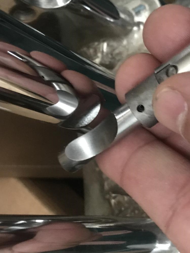

This is a picture of a new fork lock next to the scallop cutaway in the fork neck. When the fork is locked, the scallop turns 90 degrees and blocks the fork stem from rotating. The problem is: Illinois Lock didn't make this out of tough enough material and there ain't enough of it. It bends--easily--too easily.

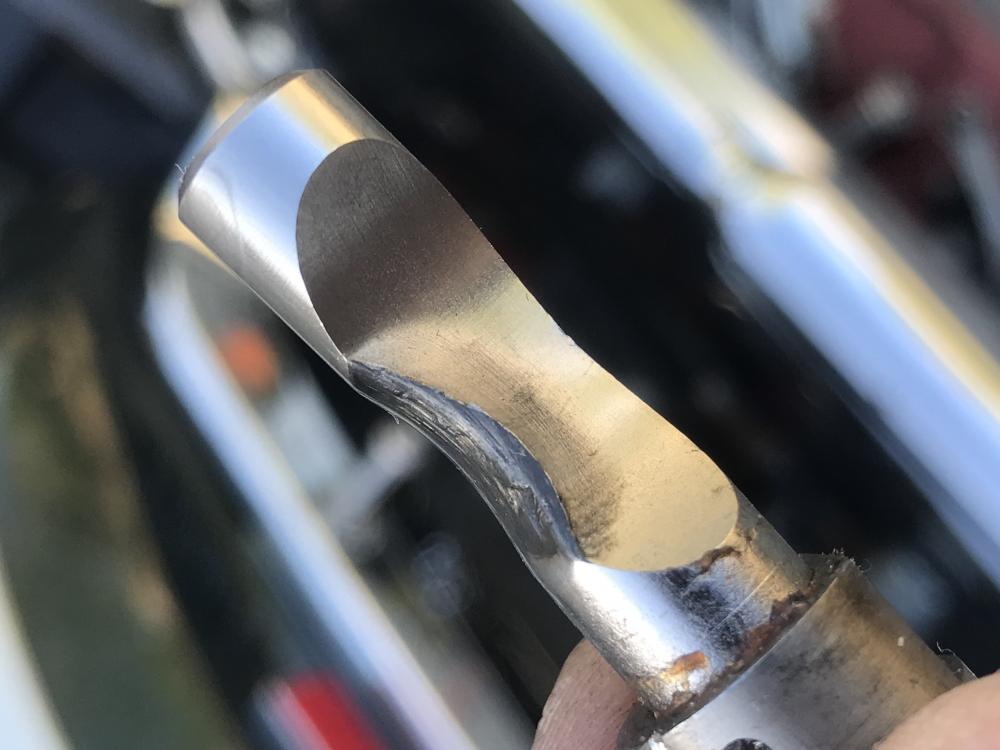

This is what the lock looked like that came out of this stem.
