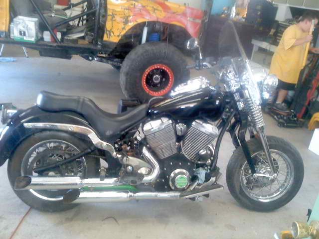

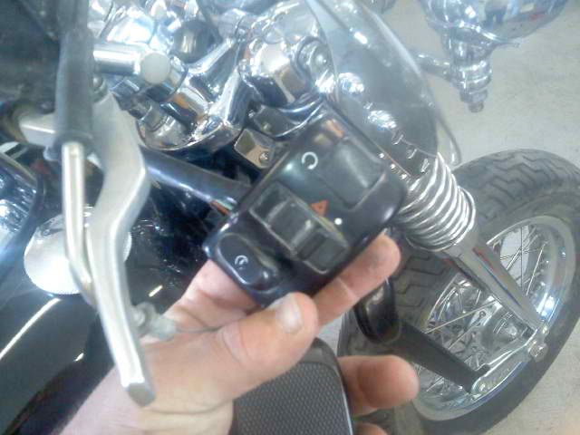

I worked on the bike a little more today and came to a stopping point of needing to buy a battery, a throttle cable and the right hand control that has the on/off switch. I can't get it to turn over and I think it's because the on/off switch is missing parts inside of it. I did manage to get quite a bit of parts bolted on and it's looking better and better. Here are some pictures
Here is the part I'm needing.

Nice one-piece seat.
Are those EH slash-cut mufflers? They look like they're spun upward. Could just be an illusion.

« Reply #5 on: September 06, 2012, 06:31:37 PM »
deadwood/jenny seat...
those mufflers do look turned up... even fatter than OEM slashcuts... wonder what they are...
Looks like you've got a good start on a wonderful machine....
keep us posted... don't speak for everyone, but I like to see progress in projects.... Cool!!

« Reply #6 on: September 06, 2012, 08:52:23 PM »
Thanks I'm loving the way things are rolling along. The pipes are factory pipes the have been cut into slash cut pipes and are super loud. I have another set of stock pipes and only one factory slash cut pipe for some reason? ::) I have a solo seat and quite a few spare parts. I have the back chrome bag rest but no brackets ::). 3 or 4 ignition switches spare valves, pistons, clutches gears and tons of gaskets. I also have a spare fuel tank and a battery cover. Looks like the PO did away with the tilt switch :o I will keep posting progress although it may be slow until I get some parts I need. :(

« Reply #7 on: September 07, 2012, 05:10:59 PM »
Deadwood handlebars too.
I would imagine a home cut set of exhaust would be unbelievably loud. I thought the factory slash cuts were too loud so I run the stock mufflers with the freeze plug thingys knocked out.

« Reply #8 on: September 07, 2012, 06:52:52 PM »
Is that an oil pressure gauge?
Yeah I have the stock bars also, not sure which ones are more comfortable? Yeah it has an Autometer gauge installed by the previous owner.
